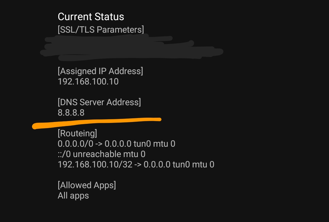

--> set "DNS Server Address 1" to 8.8.8.8 or whatever you liked
if the client (you have, or tested) DNS was not 8.8.8.8, that is the client issue not SE server
(have been tested with SE server stable, Debian 11, SSTP client on Android)
