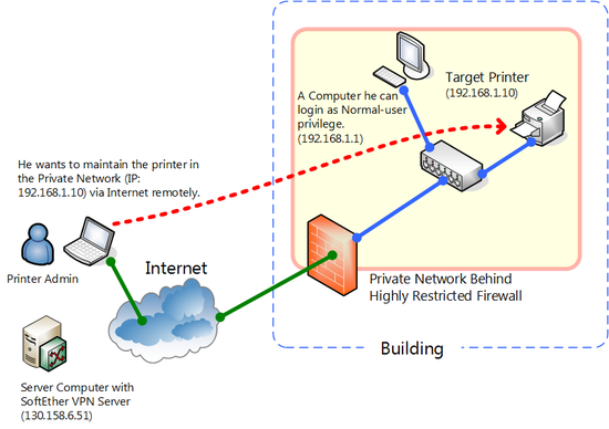

				I shortly had a look at azure.
So compared to the picture....
Softether server will be the azure server.
The vpn bridge will be installed on the raspi.
And it should basically work?
All the setting is described for the gui. That means i still struggle with the setup. Since i only have the cli.
i will look at that tomorrow. Maybe i find a more detailed howto.
I will keep you posted!

				Re: GigaCube openvpn Securenat Setup
				Posted: Tue Aug 31, 2021 6:11 am
				by maggus
				i guess i am confused.
here my setup:
my assumption is:
- raspberry runs vnpbridge (or vpnserver?!) and connects to azure vpn
- raspberry runs dhcp to be able to adjust to any network
- vpnbridge needs to know how to route packages (secureNAT?)
- azure needs to be setup to route requests to 192.168.2.201
- mobile phone (android) can connect to vpn if on mobile network (third party app?)
do i need vpnbridge or vpnserver?
where do i sign up for azure vpn? or is that done with vpnazureset?
as soon as i get back home from work i will try the steps... maybe i am thinking too complicated :-)
				Posted: Tue Aug 31, 2021 6:47 am
				by eddiewu
				You need vpnserver.
Android has several SSTP clients available, paid or free.
Turning on azure on the server is really simple. If you still can’t do that, learn from google.
